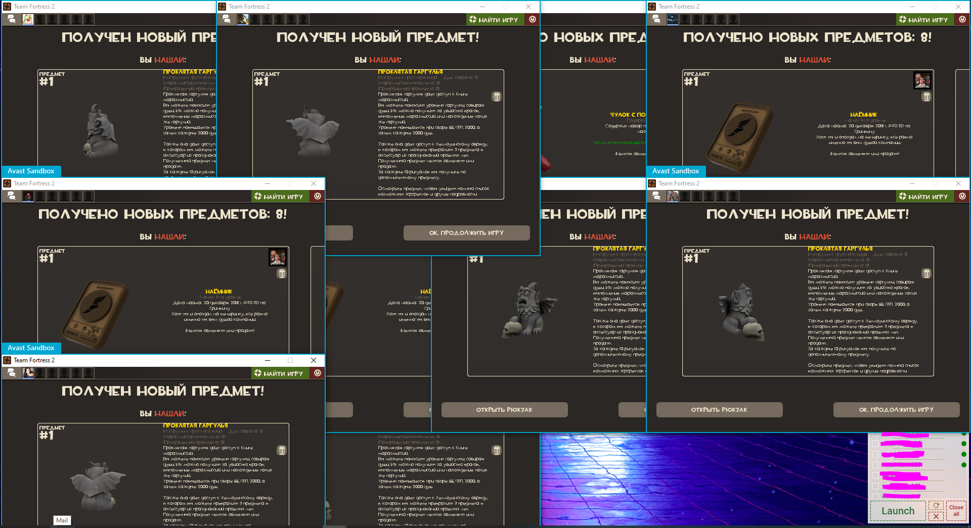

Finally, upon my 'newbie' investigation, I have found that everything working at perfect condition on my side and steam side. Steam-dropler can get list of servers and try to connect it in 'FirstOrDefault' order, unfortunatelly for some reason the first-server can't be used in my country
(or some other reason) , but Steam-dropler keep recognize it as 'validRecord' server and not marked it as 'BadServer'. The result is 'not login: NoConnection'.
After compile myself (dropler_051220_src) and skip (bypass) the first-server, I have succeed the farming as usual.
